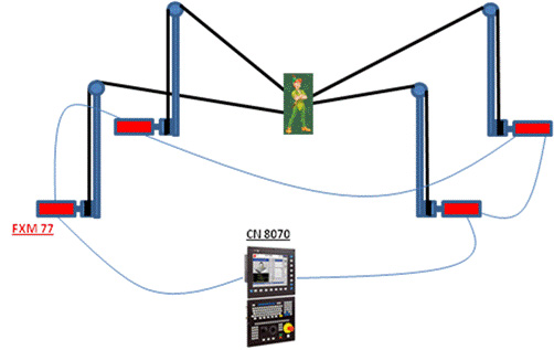

To make the audience vibrate with Peter Pan’s acrobatics, SIDE-UP, in cooperation with IDMI (Fagor Automation’s authorized integrator), has carried out the integration of parallel cables handled by a FAGOR CNC 8070.
Since this project had little to do with the usual machine-tool applications, the setup was also out of the ordinary. A special kinematics was created to simultaneously manage the whole cable system in order to maintain the balance of the actors and structures moving around in the show.
The CNC controls 4 motors in charge of rolling and unrolling the cables attached to Peter Pan. Thanks to the Fagor CNC system, the position and movements of the main actor are absolutely precise and controlled ensuring total safety during the whole performance.
